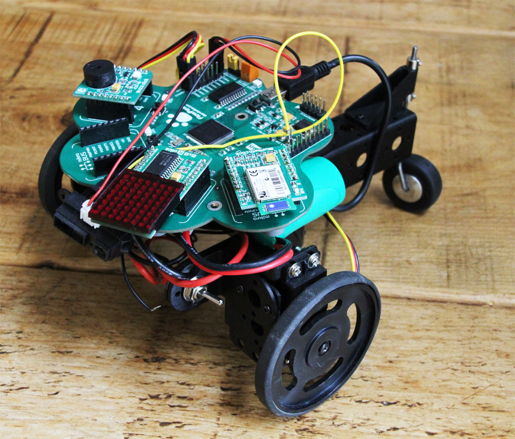

Rover 1 – LynxMotion Rover (Part of the Servo Erector Set)
FlowPaw LM Rover 1
+ve  points:  Works really well, very maneuverable, uses continuous motion servos that connect directly to the FlowPaw board (no motor controller needed). Works well on all surfaces (carpet and hard floor).
-ve points: A little small for the FlowPaw board if you want to mount anything else.

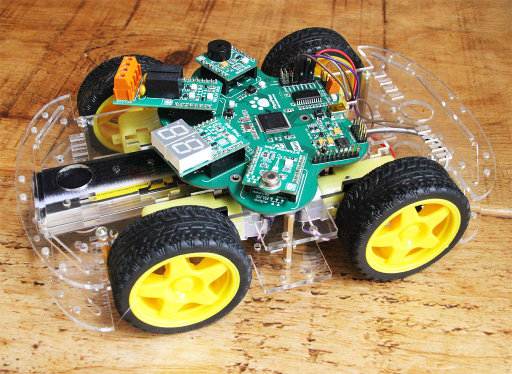

Rover 2 – Yellow Rover
FlowPaw Rover 2
+ve  points:  Works really well, very maneuverable, and fast, good price, lots of space for other components. Works well on all surfaces (carpet and hard floor).
-ve points: Needs a separate Motor controller, motors not pre-wired (soldering required)

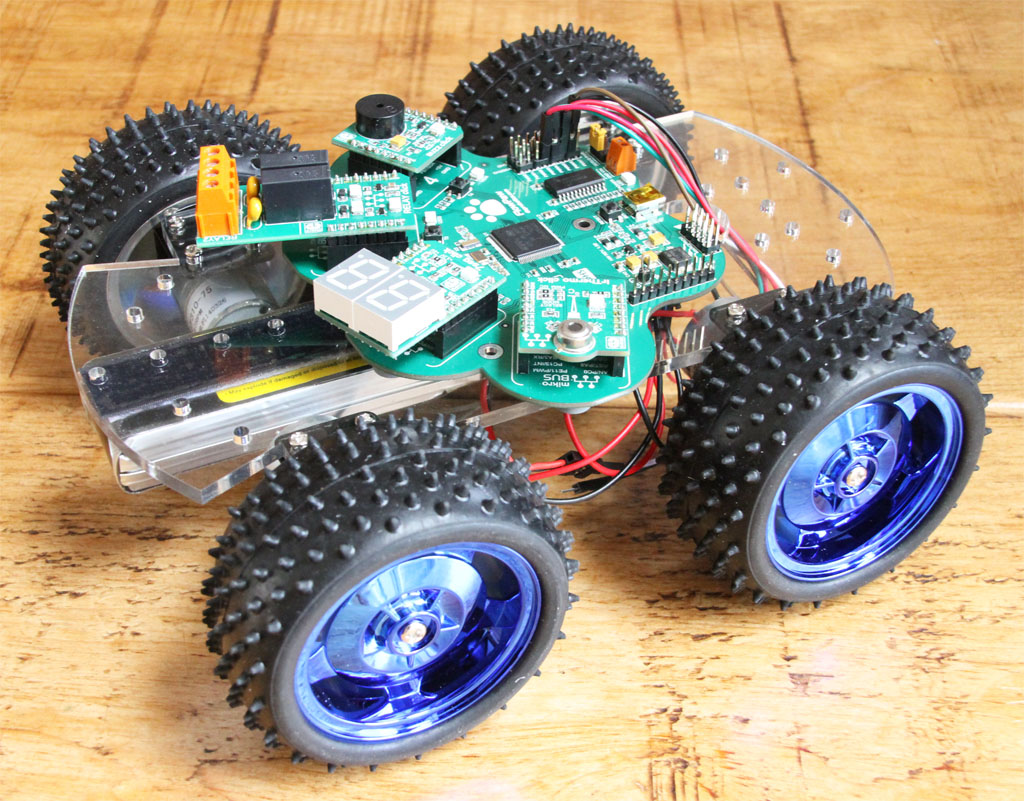

Rover 3 : Blue Rover
FlowPaw Rover 3
+ve  points:  Looks cool, fast, lots of space for other components.
-ve points: Needs a separate Motor controller, doesn’t work on carpet (the wheels are too knobbly and wont skid – needed for turning), motors are pre-soldered with wires, expensive.
So the winner is : Rover 2 – The Yellow Rover!

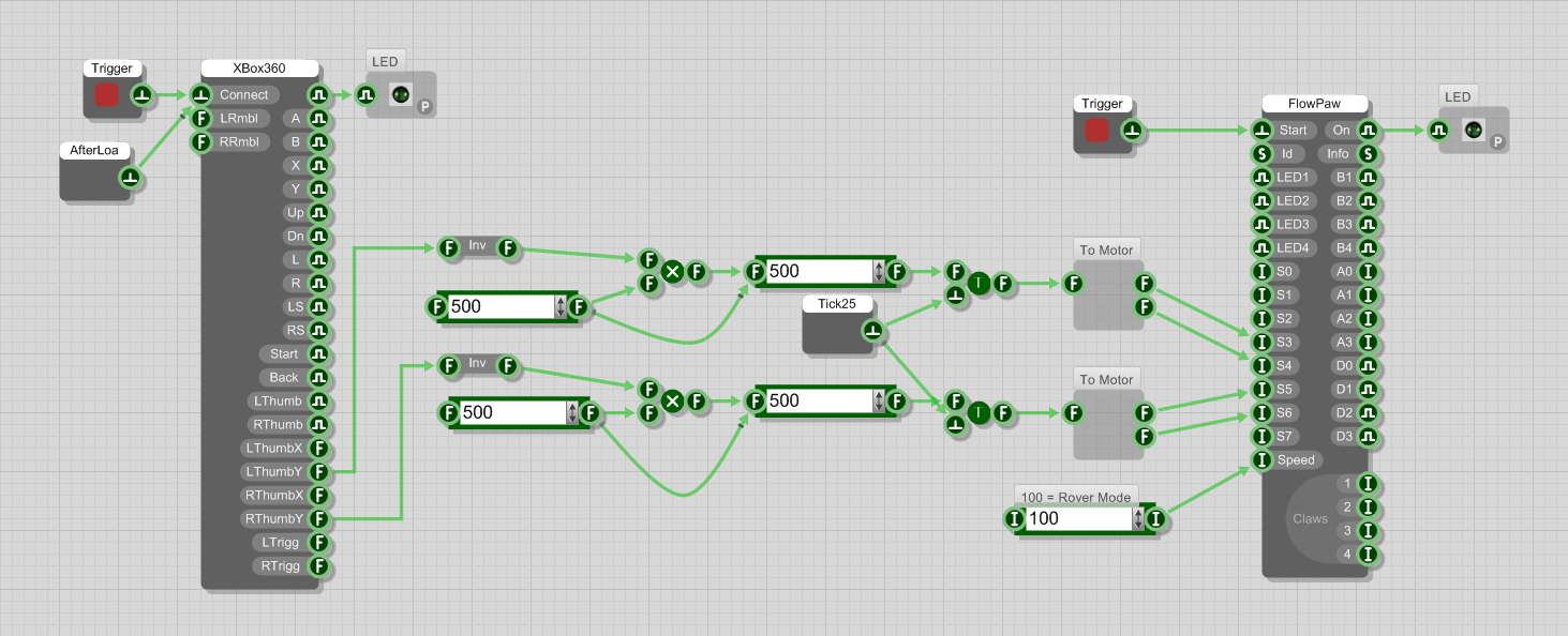

Here’s the FlowStone code we used to control it using an Xbox games controller:
FlowPaw Rover2 clip
  • Input S3 = Left wheels Forwards
  • Input S4 = Left Wheels Backwards
  • Input S5 = Right Wheels Forwards
  • Input S6 = Right Wheels Backwards
