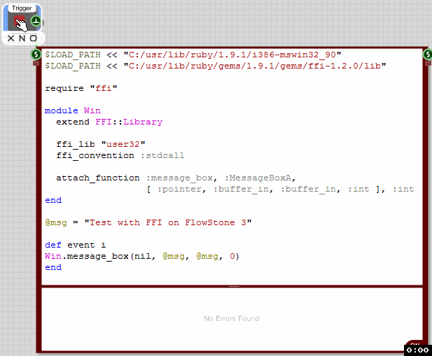

I managed to create a full version which also supports yaml and zlib,
so to have the ability to install gems (when package is ready, I try to put it online for download).
so now some tests:
installed the gem FFI, works really well,
but here FS3 after a while I get the message that you can see, (please click on image an wait) :shock:
now I wonder in the future it will be possible to disable this protection?
Otherwise, any process that is not executed within the time set will be judged to be locked,
but in reality the example is just waiting for you to press the ok button.
Malc there are tricks to be taken?
I hope this will work without ruby goes off.
Test with FFI on FlowStone 3.gif (626.87 KiB) Viewed 33000 times

There's quite alot to digest here. After a quick scan I'd say that what you're doing is indeed correct - well, it obviously works so that's as good a test as any! :)
Regarding the protection, you're right there are situations where you could be waiting for the Ruby thread to return but not be in an unrecoverable situation. We don't currently have a way to get round this but I can see it would be useful if we did. We will need to have a look into it.
Nice work btw.
