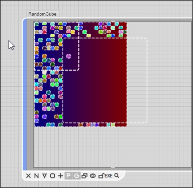

I am not sure if understand you right, but empty mgui layer with redraw on top will do this:
Snap 2021-11-21 at 18.03.32.png (39.69 KiB) Viewed 33946 times

I think you have to understand that you are using some cheat or trick in FS, and what you see is actually not there. You must do some 1 per sec. tick or one pre 10 sec. tick to make the rectangles still there, you have only two modules - that means only two rectangles fill the area 25x times per sec. at around 1% of whole area. So I suggest 100 would fill it all the time you set on ticker.
