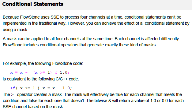

It is always a good idea to consult the User Guide first, so let me start with that:
Let's elaborate a bit. There is the & operator, a "bitwise and" for the arguments left and right of it. In the example given, one argument is a boolean expression (x >= 1) and the other is a float number 1.0. Both have a 32 bit representation in FS per SSE channel. The boolean expression is either true or false:
true  = 11111111111111111111111111111111
false = 00000000000000000000000000000000
Float numbers are represented as bit patterns according to the IEEE 754 standard, which for the example happens to be
1.0 = 00111111100000000000000000000000
"Bitwise and" means that each of the 32 binary digits is evaluated to 1 if both those digits are 1, and is zero otherwise. At the end of the day, all you need to remember is the following:
number & true  = number
number & false = 0
By the way, the order of the arguments does not matter, so bool & number is the same as number & bool.
