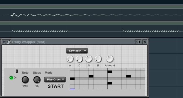

trogluddite wrote:a modules that locks to the phase of VST PPQ etc. ought to be possible
How are you going with this Trog?
My timing tests are not hitting 100% accuracy. Looks like it may be required.
Re: accurate midi?
Posted: Tue Feb 26, 2013 10:27 am
by billv
