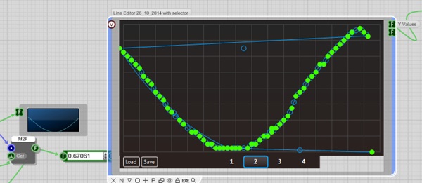

I am working with the line editor , The output from the line editor is an array of floats.
However it saves its output as an array of points.
After load of an envelope shape it converts this point array into a float array.
But, and here is my question...
Is is possible to do this the other way around ,i.e taking an array of floats and convert them to an array of points?
For example , I can convert an lfo to a float array , now I would like to convert this float array into a point array so I can "load" the lfo shape into the line editor.
I feel like there should be a way to do this , quantising the lfo into discrete float values, gathering them into a float array , then convert that float array into a point array .
I hope I am making sense , could post an fsm if needed?

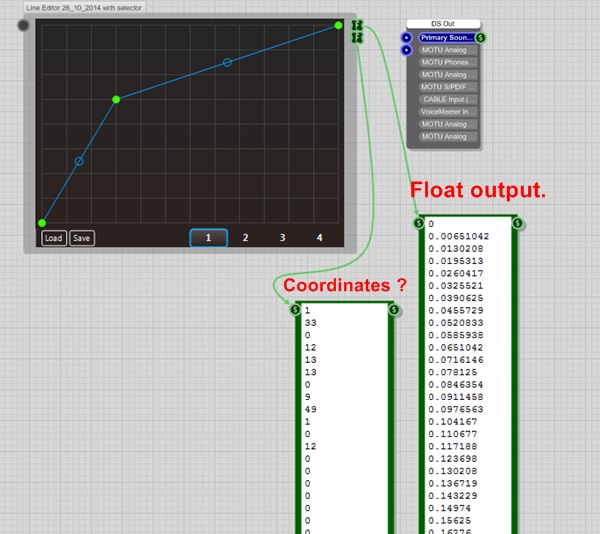

Maybe this explains better.
From the Line editor output comes a float array.
But to save/load and store to preset it uses some sort of "coordinate " (or something ?) system containing an array of 64 points.
So to input something to the line editor I need this "coordinate" format.
What I want to do if possible is convert a float array to this "coordinate array".
For example to convert an lfo shape to show on the line editor.

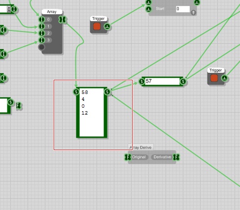

I am almost there , I have converted a float value to the "coordinate" thingy the line editor needs.
But , Now I need a way to stack these 4 values into an array , cannot figure out how ??
Preferably I would like to take the four values and move them into an array stacking on top of the previous 4 values until I have the correct array to send into the line editor.
Any thoughts?
Any thoughts?

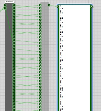

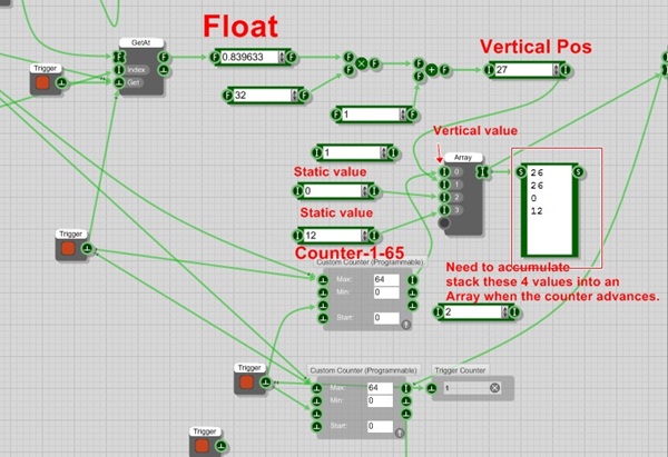

I am using the array builder to insert the fixed values which are the tension and curves shape, so these are static.
Two changing values I need , X/Y.
I am using a counter that counts from 1 to 65 for the horizontal values into the array builder.
And the divided float values to int into the array builder as the vertical values.
As it stands I have this 4 value list with 2 static values and two changing values , what I need to do is "append" or stack up each of the 4 numbers everytime there is a change (the counter advances)
If only I could take the 4 values and sort/stack them into an array , I would have this pretty much solved, except for maybe some sync and timing issues.
As I could not find a way to stack them up I put them into a huge multiplex ,counter to switch it.. each 4 values written into a separate list and all these lists into one list , this way it at least stack up...so this shows that the idea works , I get a list that I can load and everything is sort of working but is a lousy solution. Not even really a solution , there is the issue of multiplex holding values and the whole thing is a bit dodgy.
Sort of works, proof of concept at least
It feels like it should be simple to take the 4 values and append/stack them into a an array whenever the counter advances , I must be missing something ..I imagine it should be easy with ruby ..i just suck at ruby .
