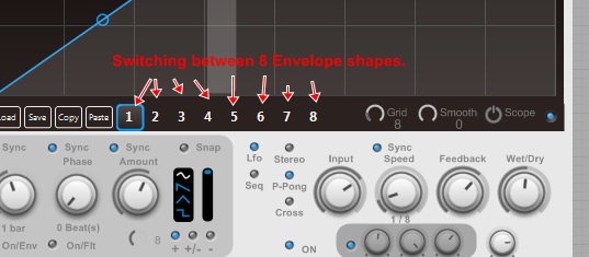

I am trying to automate the state selector for this advance envelope - switching between the 8 presets.
It is set to rec to and automate from host , shows up as a parameter in Reaper, but will not automate when I apply a curve and I cannot see why ?
Can anyone have a look at this and see if they spot the problem ?
The VST param for the state selector can be found in the save/load - 1-8 preset bar.

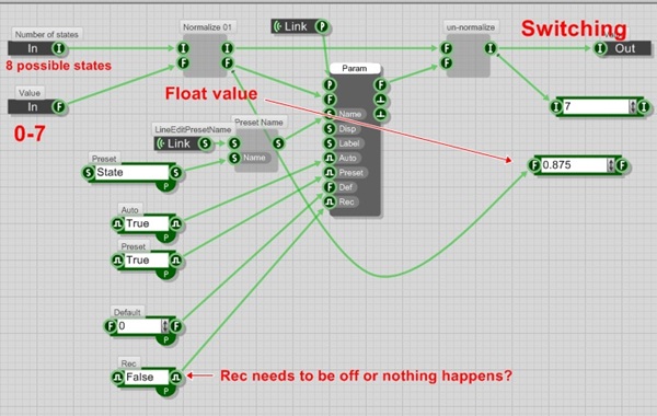

I meant "test" as in implement it and understand how it is "normalized" , I have not encountered this before where I need to automate a 1-8 state or where I am switching between 8 values. I guess I somehow figured that the preset module would "convert" any values at the input into a float representative and "ignore" input values.
Problem number 1,
I am switching between 8 envelope shapes , using integers from 0-7.
This needed to be "normalized" or converted to float between 0-1.
rec 2.jpg (39.2 KiB) Viewed 29061 times
Om's solution was to "normalize" the values to get float value to represent 0-7
This however requires the Rec to be disabled or it does not work to automate it.
Other then that this worked for the example posted which is just the basic advanced envelope , except that it has been changed to 8 possible shapes rather then 4.

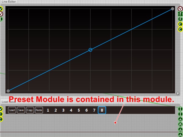

"If they're off, they're in an undefined state and it depends on the various products how they deal with out-of-spec VST formats." There is probably something like that happening here in problem 2, although it seems to be set up correctly?
I will make a simpler example but If you want to check either my initial example posted*which did not work for obvious reasons) or Om's solution then the preset module for the switching is in here.
