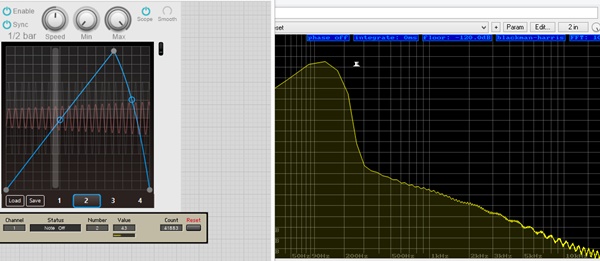

I am using this volume shaper/line editor that I found somewhere .
At this point I am using it for volume only , similar to LFO tool.
For some reason when I send a sine wave through it for testing when the envelope rises or falls it creates this raspy sound , adding harmonics , noise. I tried adding some smoothing/de zipper on the output of the envelope and yes it does help but at the same time it smoothes the envelopes. What I would like to achieve is a noise free envelope and use the smoothing for effect or to fix clicks.
Any thoughts ?

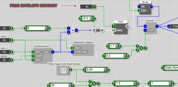

the problem will be in the stream code not the envelope editor, you should post the full project with the problem, perhaps we can help you better then.
Re: Volume shaper /Line editor causing extra harmonics, nois
I don't know any Ruby but this is creating a 385 element float array. How are you using this array?
Since this is in green and generated by Ruby it may well be that the timing is too slow and inaccurate or it has insuffcient steps leading to quantisation artefacts. It depends on how you're using it. It won't be fast enough to modulate audio in real time.
If you could upload what you have, to show the problem better, it would be easier to check what's happening.

You should be using some kind of interpolation to read values from the array. Linear interpolation should be fine.

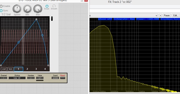

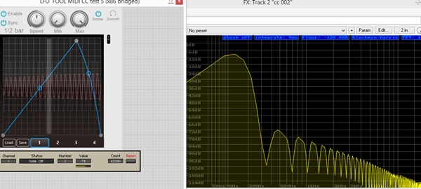

This is how it measures with the interpolation, still some obvious artifacts.
I can hear less artifacts then before though, so that is progress....I think?
Not a very fast envelope 1/2 bars
Disabled, Sine played through.

Enabled , Sine plus artifacts.
dirty sine.jpg (63.21 KiB) Viewed 29654 times

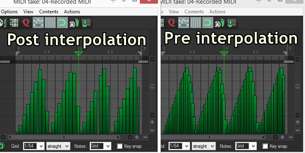

And still some pretty low resolution CC output, I am assuming that is the same issue.? It even looks a bit worse.

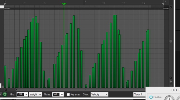

For some reason it sounds a bit better after the interpolation changes , (edit, after listening , it sounds far better, but still has artifacts) but it seems to be lower resolution , at least for the cc output ? Pre interpolation is much better for the cc ouput as far as i can tell, but still not good enough , should be much higher resolution and denser.
interpolation cc.jpg (78.86 KiB) Viewed 29652 times
Also the audio looks cleaner before the interpolation, although I can clearly hear artifacts on both.
Before Interpolation - Sine - 1/2 Bar.
Dirty sine before interpolation.jpg (58.16 KiB) Viewed 29652 times
After Interpolation - Sine - 1/2 bar.
dirty sine.jpg (63.21 KiB) Viewed 29652 times
Not convinced that did the trick, can I increase the resolution of the interpolation or is there something else I can do ?

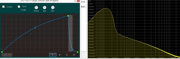

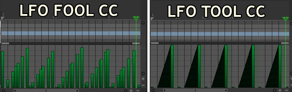

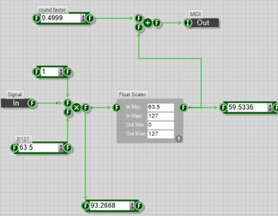

Still seem to have a problem with low resolution CC output .
I did a comparison with LFO tool , and it outputs hi res /dense CC.
LFo tool fool.jpg (45.92 KiB) Viewed 29626 times
I do have to rescale the Midi CC , if I plug it into the envelope output it will output zero to max as 63-127.
So I plug it into a rescaler to make it go from 0 to 127
I wonder if the rescaling affects the resolution, although I doubt it ?
Do I need more ticks then 100 to achieve higher resolution ?
I am having a hard time finding any modules/synths in my library to see how this is done.
