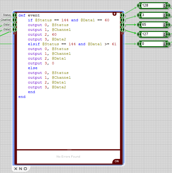

Hello,
I'm currently using FL Studio 12 where Flowstone is integrated and what I wanted to do is to create a plug-in which has "Low-Note" or "High-Note Priority" because I couldnt find anything in the Internet.
So if I play any note on my MIDI keyboard (i.e. C4) every higher note should be disabled as long as C4 is played. If I release C4 every note should be playable again. The notes below C4 shouldn't be affected
I'm really new to coding so I don't really know what to do
Hope you can help me :/
- Flowstone1.PNG (37.93 KiB) Viewed 18534 times
Last edited by Andreas Ruland on Fri Feb 03, 2017 9:31 am, edited 1 time in total.

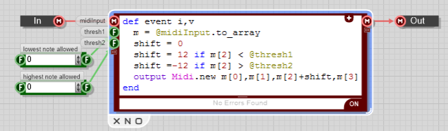

Re: Midi Note Priority
Hi Andreas,
I'm too busy 2... but maybe this little gem from nubeat7 gives u a hint:
or this: http://www.dsprobotics.com/support/viewtopic.php?f=3&t=3294&p=17614#p17605
- midi note manipulation by nubeat7.png (34.36 KiB) Viewed 18415 times

Thanks for your help!
I think this is a keyboard split right?
Ok I think some programmers here will call me crazy x) but after a few days of googling I found that "priority queue" thing and the way I did it works but is totally buggy and I think there gotta be a much easier way.^^
