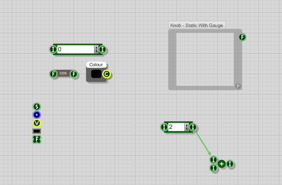

Not sure it this helps but, after startup and the error pop-up comes, flowstones interface
does all load up. if you drag the error screen out of the way, there's this
This is supposed to be the example file yes?
I saved it, just in case it may help

The screenshot you posted is indeed the example schematic but of course none of the Ruby drawing is working there hence the reason it all looks a bit odd.
