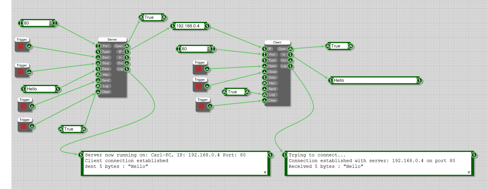

Here's a working example that sends data to and from the same PC to test the networking.
1) Start the Server
2) Open the Client
3) Send data from Server
1) Start the Server
2) Open the Client
- New Network Test.fsm
- (428 Bytes) Downloaded 1242 times

Re: Networking & FS
If it can't connect then the port could be blocked or being used by something else?
Try some different port numbers (eg. 1000), this works here but you may have to open the port in your router.
Does the Server start ok (must be started first)?
Here's what it looks like here :
- New Network Test clip.png (143.95 KiB) Viewed 27061 times
