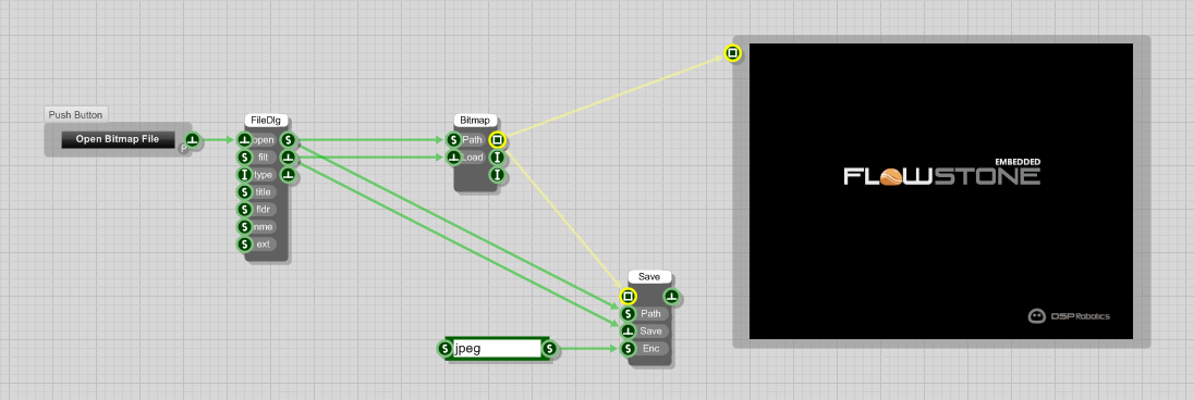

You can use the Bitmap Save Module and set a different file type: BMP,JPEG,GIF,TIFF,PNG
Here's an example:
Bitmap to Jpeg clip.png (53 KiB) Viewed 9451 times
Bitmap to Jpeg.fsm
