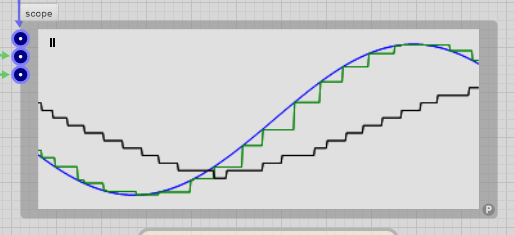

Im trying to make a LFO with float output to use this for commanding knobs.
seems obvious but...
i monitor the result with scope (cf shematic)
but with classic signal to float i get an awful stepped curve
with signal to float + (various) de zipper-smoother I get stepped curve with less visible step, but loss of the amplitude, and phase decay (anyway not a smooth suite of float)

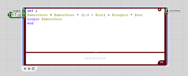

I think you need something like this, but I can't get it to output anything->
how to code the ruby_query_.png (35.65 KiB) Viewed 26266 times
RUBYfloat smooth.fsm
(354 Bytes) Downloaded 992 times

Here is a scope trace directly from your example. You can see the sample time period from green is inconsistent. As I undertand it whenever you go into green you'll ht this issue. You can see the conversion from the 2 positive-going edges are significantly different as a result.

I am certainly not arguing that the floats are hifi,
they are 500hz.
Here is the higher samplerate realized by turning slide on,
which is surprising IMO-->
less float quant from slide.png (18.93 KiB) Viewed 26239 times
