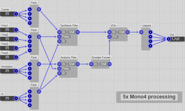

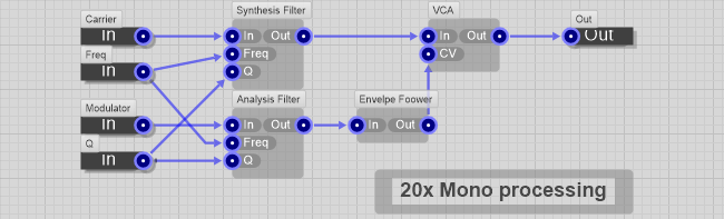

Re: Bobs Vocoder with format shift
Bob,
instead of this
you could do like this
One remark: You are using static filters with green input, so you can't pack the frequencies. In that case you would have to pack the filter coefficients. Alternatively, you could use dynamic filters and hop the coefficient updating by 4096.
BTW should it not be 'Formant' instead of 'Format'?
instead of this

Re: Bobs Vocoder with formant shift
BobF wrote:So, just for my knowledge then, what if I packed everything but the frequencys, would that still work and would I still get a cpu usage cut?
The point of SIMD (single instruction multiple data) is that every instruction is actually operating on 4 data sets. If you don't pack, all 4 values will be equal, so you are not taking advantage. Packing 4 channels into one Mono4 stream amounts to "buy one get 3 for free".
Note that in my schematics the carrier input, the modulator input, and the Q are packed with the same value in all 4 channels. This is actually redundant. I included it for clarity, but you can leave it out in the final schematic.
BobF wrote: Is it a pain to pack coefficients.
Well, yes, because each filter has 5 of them...
BobF wrote:Maybe using your dynamic band pass filters is the way to go. Is anyone route better than the other?
If I were you I'd go with dynamic filters. You could do the frequencies packing in stage0 to save some overhead.
