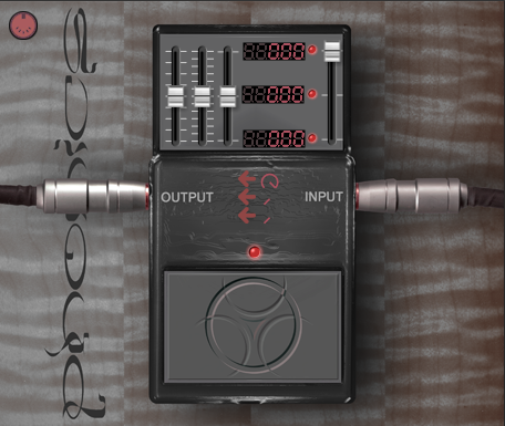

It has 3 lines,
so you can play a chord.
Hope you like it,
I'm glad to get this working.
It sounds pretty good IMO.
Hope it gets tucked away in ur VST folder.
