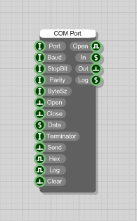

FYI: we have just made a new COM Port module that does everything in one module (Strings and Hex Data In & Out).
This should solve any issues you had and make it easier to use. Also it means that you will be able to get data in and out in FlowStone FREE as it is a single module
This will be in the new update next week!
- New Comport Component Image
- ComPort.png (13.3 KiB) Viewed 28068 times
