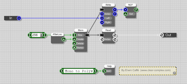

Mono to Poly's been around since SM days.
Re: Mono to Poly question
Posted: Tue Jul 07, 2020 12:21 am
by nix
yeah, that one writes and reads the stream,
in an early hack
Alpha made that a prim iirc
this implementation is more sophisticated it seems,
involving tagging the streams
