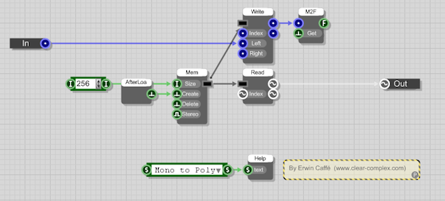

Re: Mono to Poly question
Mono to Poly's been around since SM days.
nix
Posts: 817
Post by nix »
yeah, that one writes and reads the stream,
in an early hack
Alpha made that a prim iirc
this implementation is more sophisticated it seems,
involving tagging the streams
