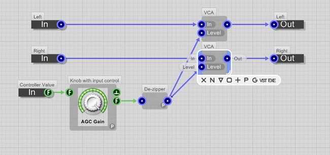

This is one idea I used for a project.
VCA control.jpg (61.9 KiB) Viewed 26407 times
Here's the example schematic:
VCA control.fsm
(121.55 KiB) Downloaded 1088 times
Re: Crazy question
Posted: Sat Jul 30, 2016 8:56 pm
by BobF
Hi again RJHOLLINS,
Thank is exactly what I used. Can you show me where and how the midi data controls this!
Thanks once again, BobF.....
