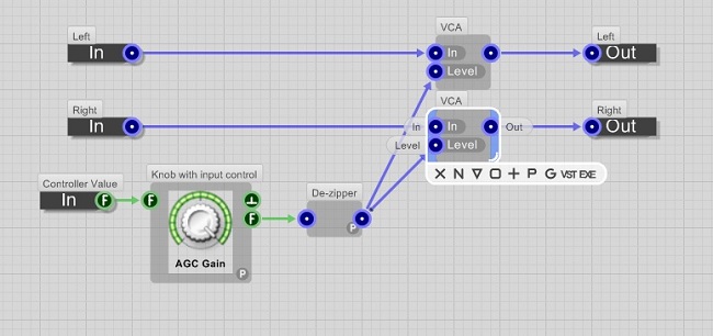

This is one idea I used for a project.
VCA control.jpg (61.9 KiB) Viewed 26396 times
Here's the example schematic:
VCA control.fsm
(121.55 KiB) Downloaded 1088 times

Hi again RJHOLLINS,
Thank is exactly what I used. Can you show me where and how the midi data controls this!

Hi BobF,
I'm not exactly sure what you need to do ... my guess ...
You want to use MIDI data to set an audio volume. If so ...
Audio data into the knob [if you want to use it], is scaled from 0-1
MIDI data is 0-127
There are some 'scaling' modules that will correlate one range of values to a different range. That is, values from 0-127 will be re-scaled into 0-1 values.
These scalers might be on the FS forum. I know we found them on the old SM forum.
If this is what you want to do ... If you need the 'scalers', let me know and I can post here for you.

I think Bob wants what is called Keyboard Tracking or Key Tracking or Key Follower. Have a search with those keywords and you will find lots of info :D

Yes you are correct, scaling is what I believe I need. If you have something, sure I would like to see it.

Here are a few 'scaling' modules from my toolbox. These are User contributions that I collected.
8-)
Scaling [various].fsm
(24.27 KiB) Downloaded 1067 times
