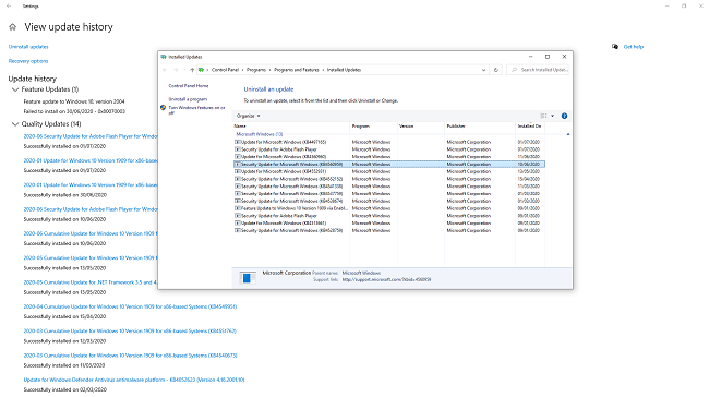

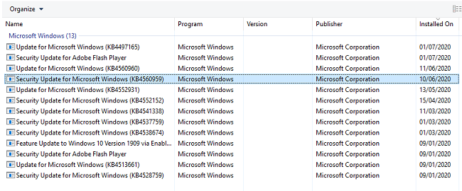

This is the one.... and the one above...
MS Update.png (78.7 KiB) Viewed 20335 times
MS Update01.png (110.38 KiB) Viewed 20335 times
There is no way to uninstall it... the others when I click on them, I have the option to uninstall... not these 2 :(

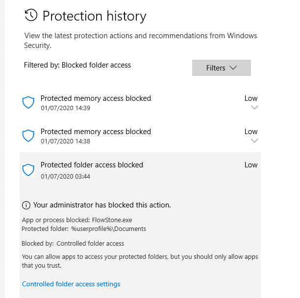

This update generates this
MS Update02.png (284.62 KiB) Viewed 20335 times

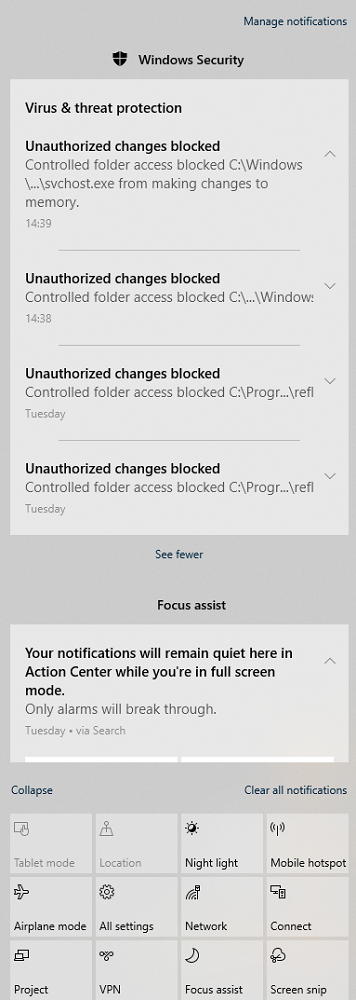

which leads to this
MS Update03.png (32.77 KiB) Viewed 20335 times

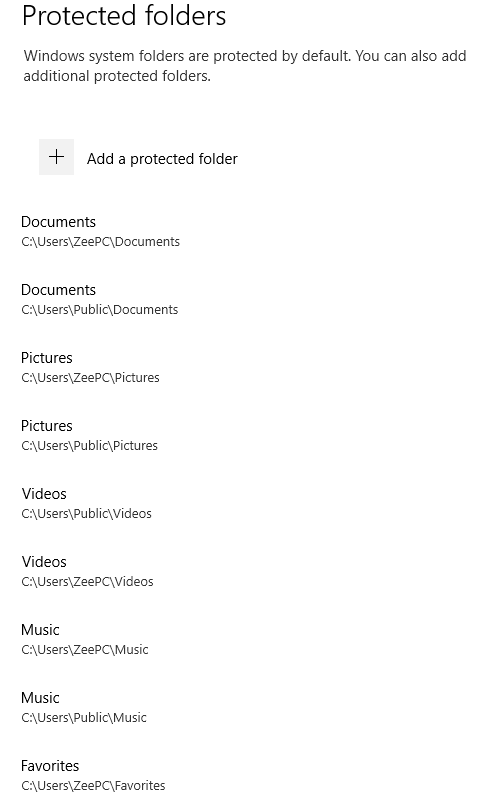

which bring us to this
MS Update04.png (18.76 KiB) Viewed 20335 times

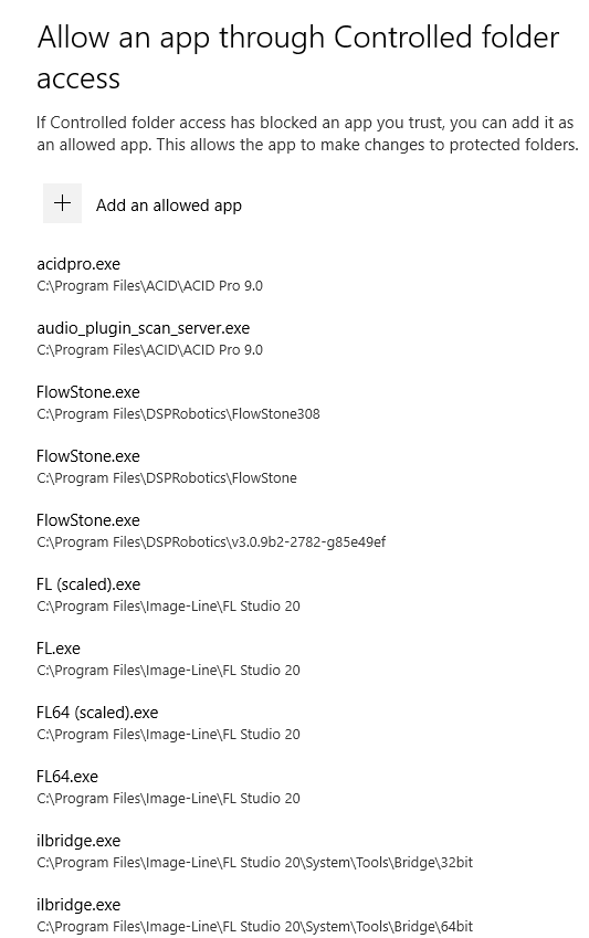

MS Update05.png (34.11 KiB) Viewed 20335 times
There is no way to unchecked folders individually...
The feature has to be turned off...
And when you chose to allow an app... each new instance is considered as a new app...
So the whole thing starts over and over... :o

Posted: Wed Jul 01, 2020 5:52 pm
I highly doubt it's ...959 that's making problems. It is just an update for the windows update installer. But ...960 is the one known to have caused some silly issues, being a cumulative system update. However, you are the only person on the whole wide internet that has this issue reported, so chances are very high, that it is a local problem rather than a Microsoft induced one.
Windows 10 creates restore points before any update without exceptions. You can always go back to a previous version that way. No need for manually messing up the system folder!
