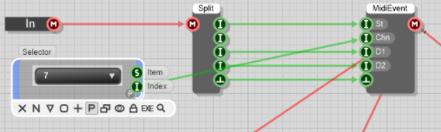

I've attached a very simple schematic that has the selector intercepting a splitter and event, with a single oscillator downstream. This is as far as I made it after watching a few youtube videos and poking around the manual.

The basic outline of the algorithm is:
6 channel selectors/splitters splitting 6 of the channels of incoming MIDI data to a separate oscillator with pitch bend data as a automate able parameter.
Alpha 2782
Re: How Can I Split MIDI Channels
I'm focusing on the bare basics here, and tell things that you probably know. But I want us to talk about the same things, so let's find the common ground.
1) Every Flowstone plugin has a midi input.
2) Which channel this midi in stream represents, is determined by the DAW.
3) You can create a plugin that provides 6 midi inputs (actually any number, but here for the 6 strings), but the DAW must be able to handle multiple inputs per plugin
4) Which channel is used per input is determined by the DAW.
What you will never have is one midi input that carries 6 different midi channels in parallel. In serial progression it would be possible, but that defeats the purpose here.

I managed to do a midi separation by input channels with Flowstone version 3.0.6, however I have another scheme with the same structure in the same version and it is not working, I attach the first scheme that works:
I tested it with SpringBeatsvMIDI to virtually communicate Flowstone with Fl Studio and thus test the channels
4 osc Midi Split.fsm
4 osc midi channels Split - FlowStone v3.0.6
(96.39 KiB) Downloaded 1224 times
