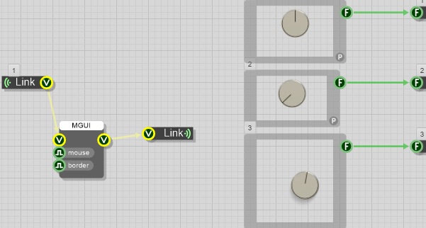

1. Switching panels is easy, use a multiplex with a wireless link into each module.
Then place a wireless into each module that you want to switch, taking care to name them either sequentially or use unique names for each one.
Switch 2.jpg (59.35 KiB) Viewed 21816 times

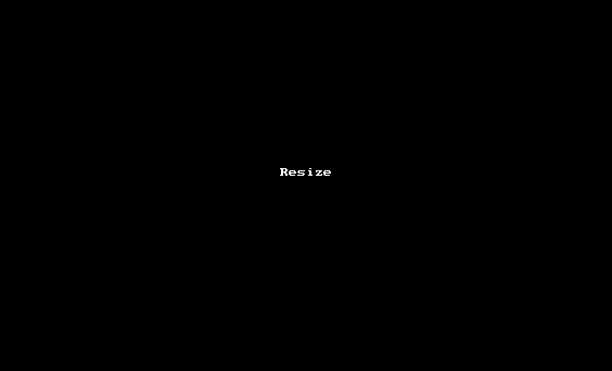

Here is a resize thingy.
Resize.fsm
(70.56 KiB) Downloaded 1292 times

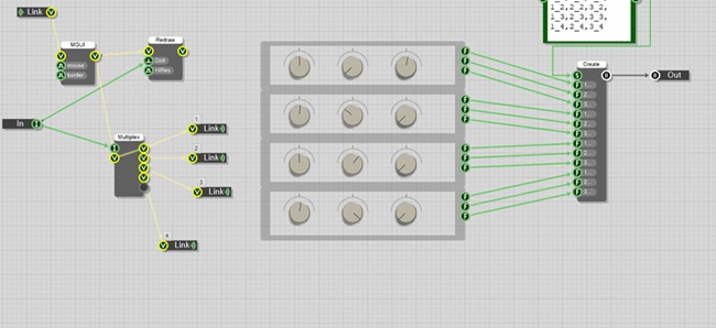

Post by lalalandsynth »
Simple Gui Switch
Simple Gui switch.fsm
(7.79 KiB) Downloaded 1289 times
