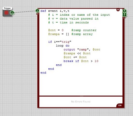

Is it possible to build a slow Ruby Ramp generator?
I have looked on the forum and tried to make one in Ruby but it crashes, pretty much on every try...
I need to make many random ramps that are slow, and was hoping I could do it in Ruby. I landed doing it in the DSP, but was wondering if slow waveforms can also be generated in Ruby as well ? ? ? And by slow I mean about 10 samples per second or so...
I forgot to save before I ran it - it crashed, but I took a screenshot :oops:
Failed Ruby Ramp...
Failed Ruby Ramp...

yes, this can be done. However, I'm not sure what you're trying to achieve exactly, so here are my few attempts:
1. From the image I see it seems you what to generate a wavetable for a ramp.
#inputs should be named "length" (float) and "tick" (trigger)
def event(i,v,t)
if i=="tick"
output 0, (0...@length).map{|i|
i.to_f/@length
end
end
