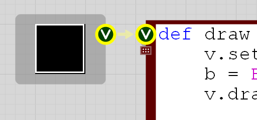

There are times when you need to draw pixel-accurate. Unfortunately the brush and the pen act differently, and the brush is the one that acts correct.
Let's have a look at a rectangle drawn two times, first with the brush, then with a pen. The pen is aligned "inset", which means it should behave just like the brush (no pixel border crossing, full size)
It seems to be one pixel too large on the right and bottom. Is it really? Well, let's zoom in...

Let's reduce the size by one pixel in width and height, since unzoomed it seems to be too large.
Perfect! Or is it? Another zoom will tell:

Here's another example with two rectangles, both drawn with brush and pen.
And now the issue becomes apparent. The larger pen rectangle seems to only draw half as thick on the right and bottom! Which let's me assume that "inset" doesn't really inset, but just moves the starting point by 50% to the right and bottom, and then clips to the full size.
I had a lot of problems because of that behavior. For example, on the 1:1 zoom-level it will snap to pixels, which means that sometimes the lines right/bottom are drawn, sometimes not. Especially if the values aren't as acurate as in this example.
Please consider this being a bug and change its behavior.
