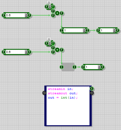

Here is stream and green->
integers.fsm
(606 Bytes) Downloaded 880 times

nix wrote:Here is stream and green->
integers.fsm
Yes. But I meant: what if you have a Float prim with value 2.234523 and you want to "round" to 2 digit (i.e. 2.23)?
Such as round in Ruby.

format.fsm
(381 Bytes) Downloaded 948 times
Formatting command was found by Trogluddite,
hope helps, but maybe not what you want

nix wrote:
format.fsm
Not sure how fast is passing between float-string-float. Anyway, that's won't "round" really to the last digit, just "cut" the string.
