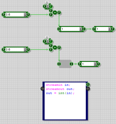

Here is stream and green->
integers.fsm
(606 Bytes) Downloaded 880 times

nix wrote:Here is stream and green->
integers.fsm
Yes. But I meant: what if you have a Float prim with value 2.234523 and you want to "round" to 2 digit (i.e. 2.23)?
Such as round in Ruby.

Post by nix »
edit- Nowhk mate, this wasn't a reply to you, just showing it if it doesn't open in current FS.
I'm sure I know how to format, just a sec
