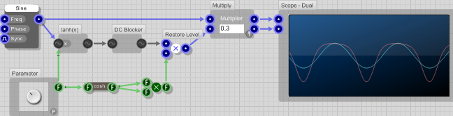

Hm, let me see, you are doing this:
output = tanh(input + DC)
correct? Then Taylor expansion to first order gives
output = tanh(DC) + input/cosh^2(DC)
so the output has some offset tanh(DC) and there is a gain reduction by the factor cosh^2(DC). So you want to remove the offset (I'd use a DC blocker filter for that) and multiply by the factor cosh^2(DC) to make up for the gain loss.
Something like this:
The resulting level is somewhat higher than the input level. This is because we are using only a first order Taylor expansion.

Wow, couldn't have asked for a more straightforward answer. Thanks Martin!
martinvicanek wrote:The resulting level is somewhat higher than the input level. This is because we are using only a first order Taylor expansion.
Is there more that can be done about that? I understand that the asymmetry will create higher peaks inherently but if I could get it closer to matching perceived volume that would be cool.
Re: Inverting an unknown function
Posted: Mon Mar 14, 2016 5:05 am
Perfect Human Interface wrote:[...]get it closer to matching perceived volume[...]
That's possible if you know the input signal amplitude. For instance if A denotes the input RMS, then third order Taylor expansion yields the following expressions for the output DC offset and the gain, respectively:
offset = tanh(DC)*[1 - A^2/cosh^2(DC)]
gain = [1 + A^2*(tanh^2(DC) - 1/3)]/cosh^2(DC)
Note that if you set A = 0 you recover the results of my first post above, so the terms with A are the correction to that.
