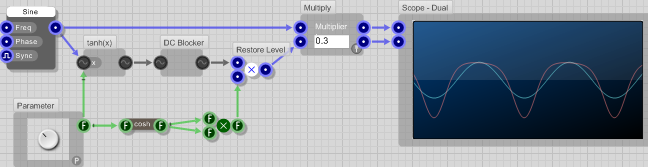

Hm, let me see, you are doing this:
output = tanh(input + DC)
correct? Then Taylor expansion to first order gives
output = tanh(DC) + input/cosh^2(DC)
so the output has some offset tanh(DC) and there is a gain reduction by the factor cosh^2(DC). So you want to remove the offset (I'd use a DC blocker filter for that) and multiply by the factor cosh^2(DC) to make up for the gain loss.
Something like this:
The resulting level is somewhat higher than the input level. This is because we are using only a first order Taylor expansion.
RestoreLevel.fsm
(13.39 KiB) Downloaded 991 times

martinvicanek wrote:The resulting level is somewhat higher than the input level. This is because we are using only a first order Taylor expansion.
Is there more that can be done about that? I understand that the asymmetry will create higher peaks inherently but if I could get it closer to matching perceived volume that would be cool.
