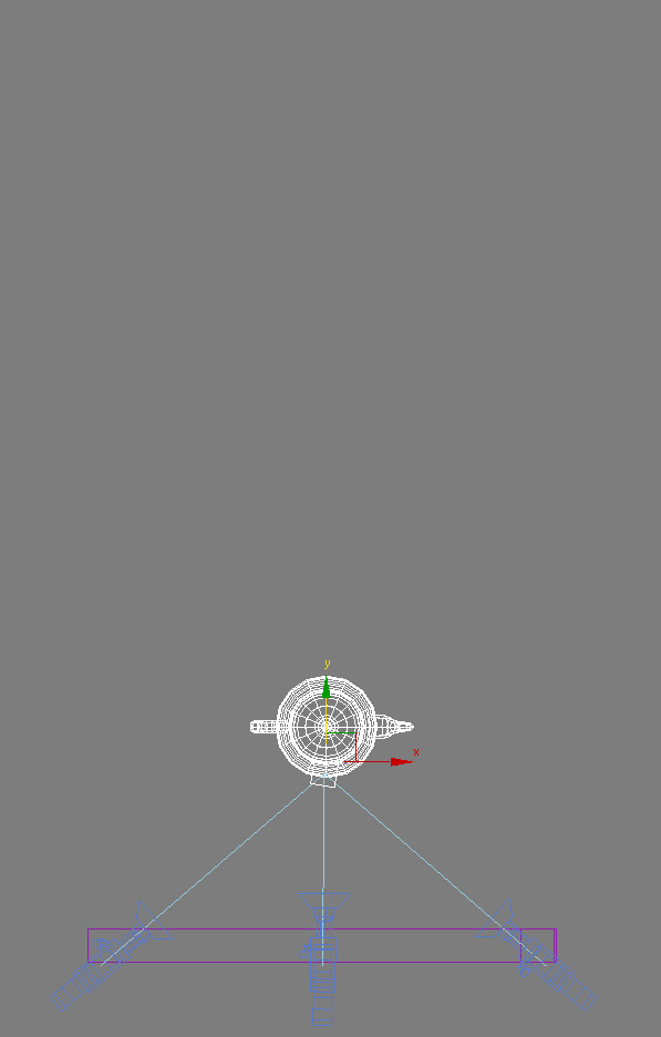

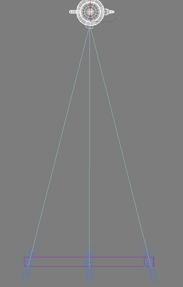

I'm studying film and am currently trying to build a motorized slider and a gimbal for my camera. Unfortunately I'm not a programmer nor a robotics expert by far and time is of the essence. I can handle node based programming interfaces like flowstone, but I'm not sure if it's capable of what I need to do with it.
The most important feature I'm trying to accomplish is for the camera to look at a static object during a dolly or slider move. Assuming that I manage to connect a motor with an encoder like this one http://www.pololu.com/catalog/product/1442 to flowstone and can controll it with decent accuracy. Camera rotation shouldn't be a problem, I already connected a servo successfully. Now I want to rotate the camera while it's moving, to always look at a specific target. If its rotation angle is simply wired to the encoder position info, it wouldn't work with targets closer than 2m. So it can't rotate at linear speed, it has to accelerate towards the middle (of the slider where it's closest to the target) and slow down toward the ends. Mabe by calculating the angles of the triangle formed by starting point, end point and target, to speed up camera rotation for the middle where the line between camera and it's target makes a 90° angle.
I have yet to explore flowstones possibilities, but I need a shortut. If I get it to work with flowstone I'll stick with it.

Yeah thanks for the PID, that's certainly a piece of the puzzle.
I was thinking about face recognition and so on, but dismissed it, assuming it would have a notable latency. I thought it would be easier to come up with a math formula or something to calculate the angles of a virtual triangle. Like flowstone would pretend there is a target and it's making an object face it like target cameras in 3D Studio Max.
The end result should be an adjustable distance parameter. I would just have to meassure the actual distance between the camera and the objekt, then feed that info to flowstone manually. One reason I need this is for lack of curved dolly tracks. For realtime shots one could exercise tracking an objekt during a dolly slide, but not for timelapse shots.
Another effect is a little more complicated. I'm trying to achieve a kind of motion blur wich is frozen in space and the camera moves around it or through it. that can be achieved by long exposure. Every image is one slide of the camera. It looks like a photo taken from a driving car at night. But I want to put that slider on a slow moving dolly and Move it in a right angle to the slider direction. Then it seems like the camera is moving through the motion blur of another camera. The problem is though, with motion blur you don't see Objects or People getting closer. Due to the Parallax effekt stuff in the background doesn't pass by as fast as things in the foreground, thus being less blurred. But if the camera aims continously at an objekt...it would be in focus and crisp. It's simmilar to depth of field but awesome!

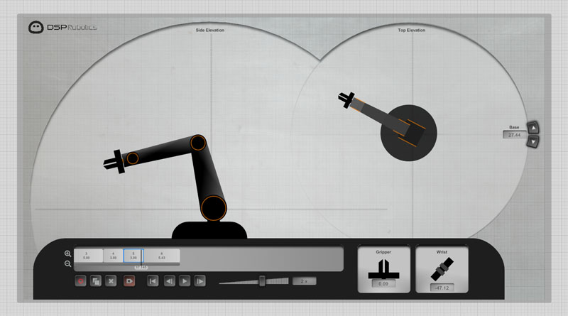

I have been working on a similar project with DSPRobotics for animating a robot arm. This has a new sequencer that DSPR has made in Ruby, it has a time line and you can edit the key frames etc. it will be perfect for your a application.
It's not quite finished yet but it should be done in a few days:
Once it's done it will be posted in the examples area for all.
