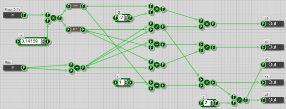

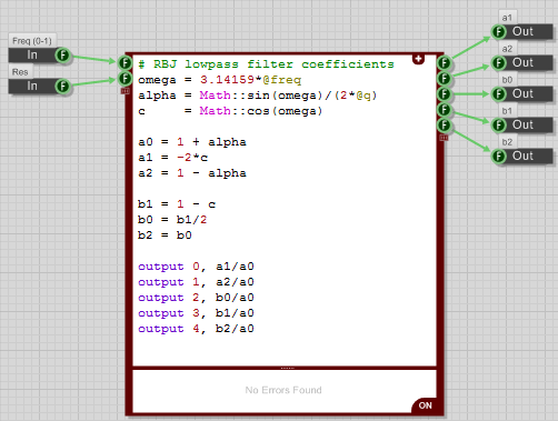

Math is very easy to do in Ruby and a good entry point for noobs like me. Here is another example which shows the advantage of Ruby over green math: a simple biquad lowpass filter coefficients module. This is how a green math implementation of the RBJ cook book formulas looks like:
And this is the same in Ruby:
I find it much faster to set up in Ruby, and certainly much easier to debug!

martinvicanek wrote:And this is the same in Ruby:
Small tip: PI is defined in Math, so
omega = Math::PI * @freq
gives you higher accuracy
