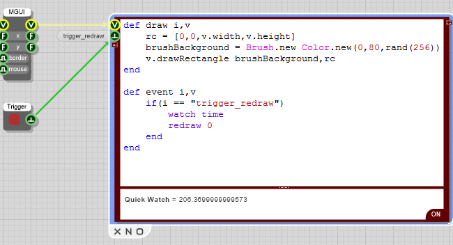

I don't understand why I'm not able to call a redrawing of my View clicking on the Trigger button:
this should be pretty easy. Every Trigger click, a new Background color (notice the rand() function). But instead, only time in the "watch" zone change.

It does redraw the view. You just need to go to the toplevel to see it. It's better if you have the trigger button one layer higher, so you can observe it better, like here:

I see. Thanks! My problem seems that I can't "prevent" redraw:

The draw method is not intended to be used for any programming/claculations/etc. It is just for drawing. The view just needs to be redrawn, when Flowstone demands it, else it would give strange results (for example when moving another view partly over the first one, then move it back. The first one would now be partly non-existent because of the missing redraw.
So, do your calculations in a seperate method, not in the draw method. For example, you could randomize the blue value in the event method (using instance variables), just before calling redraw. The result is the same: Color only changes on trigger, not on internal redraw.

I know, you teach to me this some topics ago. But my trouble is that I need to manage a huge arrays of values, and redraw it every time is so heavy. I thought to these solutions:
1 - prevent draw and draw only when I need (but seems not possible with Ruby/Draw in general);
2 - make a static bitmap once I draw it first time. Than avoid draw and use the generated bitmap instead;
I'm trying the point 2 with some difficults, but I'm almost done. Sooner a topic wih some questions! Thanks
