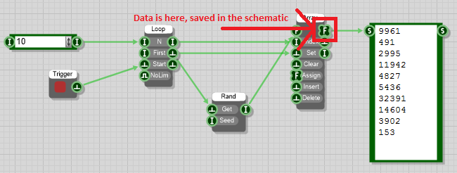

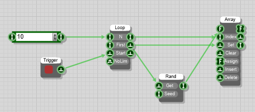

That's easy! If I create a FlowStone schematic that elaborate any kind of variables (string/float/float array/ecc), I save it and I reopen it later, I can see that all variables are "stored" inside the schematic.
I mean: if I've somethings like this:
every time I open the schematic and I link the final [F] to a text module, I always see the same generated values (when I create them, clicking on Trigger linked to the Loop module). i.e. the result is always the same. This means that the data is "stored" to the last connector [F] inside the schematic:
That's fine! Got it. But...

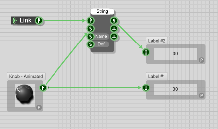

To make the explanation concise: this is how (in my opinion) thinkgs works.
Let say this is my plugin (that use Presets and Preset String prim) and I export it as VST:
when I now load it inside my DAW (init stage), it will load plugin variables and set for Label #1 and Label #2 the value 30. Since there is not any associated preset parameter value (no preset file source with data; I've not create it yet) the loading ends. I also think that here plugin will in any case create the list of preset parameters in memory, setting the current values; because if I look at the DAW preset list, I can see them with current value).
Now I move the knob to value 60, and I'll see both label updates. In this moment (I'm not on init stage anymore; but in event stage), plugin will also update VST parameter list (exhibit by the Preset Manager module; the single string in this case) to 60.
Than, I save the preset (thanks to DAW proprietary file, for example) and I reload it.
Now FlowStone first load (init) the plugin variables to 30 (so both Label #1 and Label #2 to 30 as before; of course, since I'm at init stage, it won't propagate data to VST parameter list from Preset String module), than invoke VST parameter list to refresh/reflect its value to the plugin (because this time there is a concise list of parameter with a specified value, not as before), and Label #2 become 60 (while Label #1 stay to 30).
Is it more clear? And most important: it this correct more or less?
