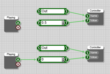

What do you mean with "retrigger it using is playing"? If I link "is playing" to the float I want to retrigger, it resets its value to 0 (if stopped) or 1 (if playing):
Maybe I don't have understand what you mean, sorry :o :shock:

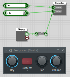

Here an example. My plug linked to the Volume knob of Fruity send.
If I manually write 0.5 (from 0, so different value) and I click enter on the Float module, I get the movement of the knob to the middle:

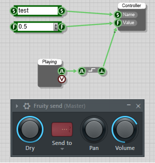

Now, if I manually move the fruity knob (with mouse) to another value (0.7 for example), and I play my DAW, it doesn't retrigger 0.5 to the knob (neither using your method above with trigger):
The knob keep to 0.7.
That's because the float module has not changed.
If I manually wrote 0.50001, it send again "0.5" (even if its not exactly 0.5, but 0.50001).
i.e. I'm still not able to retrigger the "same value", even using your method :(
