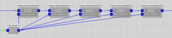

Hmm, is this:
not equivalent to this:
:?: Or am I missing something?
Re: LT2Delay
Posted: Sun Dec 27, 2015 9:18 pm
by BobF
Hi martin,
Thanks for the comment. By 5x I just meant 5 delay lines in series ( 5 times the delay time).
Later then BobF.....
