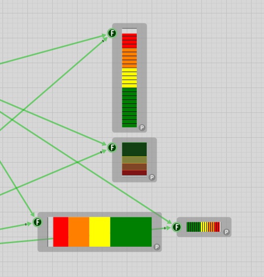

@kortezzzz,
I was working on a flexible way for graph/meters. The one attached is a sample. You can display it up,down,left or right and change the patterns as displayed in the image. You can change the colors or size with ease to whatever you want as shown. Set the value percentage to change when the signal reaches it. There is even a peak level bar. It is a positive meter from 0-100%. However, you can set the value for min-max and the meter will convert it to the 0-100% based on your value. One more add on is the delay feature(borrowed) that will make the meter dance based on fast or slow to your taste using attack/release. Was this something you were looking for? I am not finished, I wanted to see if there is a flexible way to overlay a static image for effects or display numbers etc. I do want to add the ability to change the number of meters for things like a spectrum analyzer or just a plain 2 channel or 4 channel audio output meter. Let me know your thoughts.
[img]flexable%20audio%20meter.jpg[/img]

Re: Stock led meters - horizontal version; how?
Wow, that looks great!!!
Thanks for your hard work. I wasn't even excepting for such an overkill meter. I think you better not add a lot of extra features and concentrate in solid functionality. Static images support will be awesome. For instance, using the led images we already have in the stock. I mean the ability to organize them vertically or horizontally. For numbers, you don't even have to seed it into the the same code to avoid the mess. Maybe using a separate numbers module would be better (which you can stretch and increase or decrease their size) so then we can just use them anywhere else for any porpuse and not just with the metters.
Awesome work! I'm definitely waiting for it
kortezzzz wrote:Wow, that looks great!!!Thanks for your hard work. I wasn't even excepting for such an overkill meter. I think you better not add a lot of extra features and concentrate in solid functionality. Static images support will be awesome. For instance, using the led images we already have in the stock. I mean the ability to organize them vertically or horizontally. For numbers, you don't even have to seed it into the the same code to avoid the mess. Maybe using a separate numbers module would be better (which you can stretch and increase or decrease their size) so then we can just use them anywhere else for any porpuse and not just with the metters.
Thanks, those examples were the exact same meter. I just copied it for times with each one looking different in size, shape and style. You just adjust the size with your mouse to fit. The meter is not using bitmap images, vector works much faster and more flexible. I think overlaying bitmap images will give extra effects. I have wanted this for a long time and I kept going back and forward on bitmap vs vector. If you don't like the colors, change them with color selector. Make them all the same color for instance.

Thanks, those examples were the exact same meter. I just copied it for times with each one looking different in size, shape and style. You just adjust the size with your mouse to fit. The meter is not using bitmap images, vector works much faster and more flexible. I think overlaying bitmap images will give extra effects. I have wanted this for a long time and I kept going back and forward on bitmap vs vector. If you don't like the colors, change them with color selector. Make them all the same color for instance.But if bitmap is what you are hoping for, this is not it and I do not like the current ones today because they fail to often and cause lots of screen refreshes when using a lot them. I am not sure when I will release it, hopefully soon. This will hopefully be the one meter that rules them all. No reason to create a toolbox one for only vertical vs horizontal when it can be changed dynamically. Inside there is a drop down that lets you specify direction, style and percentages.
Great. No words. A must have tool in any toolbox. Good luck. I really wanna see the final results
