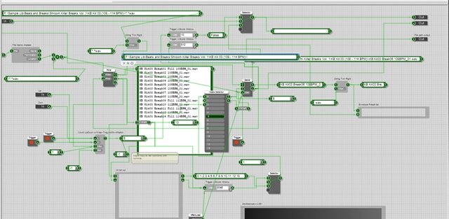

So I made a "thing" that when I load say a wavefile into a sampler (One shot) It scans the whole folder of wavefiles where the loaded file originates. Then I make knobs that select Next - Previous wave file in that folder.
It works but I am 100% sure that its a hackjob and very inefficient and way too many triggers .
"Works in the sense that it scans the folder , but always starts from the first file and is not aware if the first file loaded was number 5 for example"
Has anyone made one of these or are there maybe preexisting modules that solve this in an elegant way ?
I can upload my hackjob but its from the Alpha.
PS. Wish I had some Ruby skills, seems like that would make this particular task much easier.

Well , its a hackjob in the sense that I am pretty sure it could be simpler, maybe not ?
I guess the problem is : 10 files in a folder , I load number 5 . As I load that , it will scan the folder .
If I now use the Next Previous it will start on file 1 and advance through the list rather then start from 5.
Apart from that , it works :)
And yeah , I was hoping that someone had dealt with this before and might have a solution that would be more elegant and most of all , be aware of the number for the first loaded file.
in fact I think something like this should be a prim .
my mess.

My problem is that the list is loaded independent of the selected file , if that makes sense?
I load the file , extract the folder name , scan the folder but that list is not aware of what file was loaded.
I am fully prepared to learn that I am just doing it in a stupid way :P
I cannot know the index of the loaded file...not with my method anyway.

by lalalandsynth
MichaelBenjamin wrote:
edit:
these prims should all that's needed besides some counterfiddling and proper trigger refresh
This is pretty much what I am using, although I am sure I could simplify .
