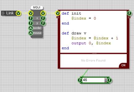

The schema is pretty simple:
every time I click with mouse on the work space, the counter increment itself: this means that draw function is called.
It is strange when working on the tools, since if I'm making graphic it messes with index/time line of processing.
That's normal? Can I avoid this? Thanks!

Re: Why mouse click invoke draw?
Here on the forums was a talk about it, if I remember correctly. You have to avoid sending to the output from within the draw method. Any output call lets Flowstone redraw the functional elements around the view (the circular inputs/outputs). For some reason, probably to take care the view itself stays intact, a draw call is also sent to Ruby.
Conclusion: Call the output method only from methods that are not connected to the draw method.
