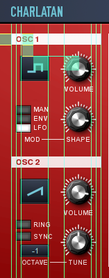

Spogg wrote:...make it look appealing...
Graphic design is a serious job. It is all about symmetry. There are different kinds of symmetry, and people may have heard of the proportio divina ("golden ratio"), which is even very mathematical:
a : b = a+b : a
How well thought and layed out, and how symmetrical the first GUI from Charlatan really is, can be seen from this second picture. I added a few lines and squares to make it more obvious:
Btw, the small buttons are divided by the line at exactly a third - not a coincidence. And I'm sure the designer made the layout when he was told the texts besides the small buttons would all be 3 letters.
It's by far not all there is, but it gives you a hint to how many thoughts go into a good design. It is not just pretty knobs ;)
