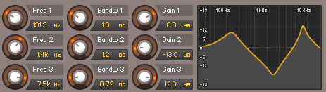

I'm also interessed in this kind of filters, if I can re-use in my plugin.
Would be nice have a sort of 3-Band EQ filter such as Kontakt:
with visual display. I can't see any "Peak filter" (Freq, Width and Gain) in FlowStone from the standard library. Is there?

Posted: Thu Feb 11, 2016 8:52 am
by Nowhk
Nubeat7 wrote:this should be included in the audiopack or?
Yes of course, but try to move a band with mouse for example: steppy, it looks freeze, not smooth. Considering I need to fast automate it, will crash, or get a bad visual feedback (which is important to me get it smooth). That's why I've asked for somethings different. Or I could try to put my hands on it and do my best :D
