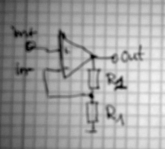

Consider the analog non-inverting amp schematic below.
The system behavior is determined by the op amp free running gain and the feedback topology. Thus, the op amp output is given by
out = gain*(in+ - in-)
where in+ is the voltage at the non-inverting input and in- is the voltage at the inverting input. The latter receives a fraction k = R1/(R1 + R2) of the output voltage,
in- = k*out
Substituting this expression in the first equation we obtain
out = gain*(in+ - k*out)
What happens if we apply some nonzero voltage to the non-inverting input? The output will respond immediately, however since a fraction of the output is fed back to the inverting input, the response will not be with the full free running gaing. We can actually compute the resulting loop gain by solving for out,
out = gain*in+/(1 + gain*k) = in+/k
the second equality being a high-gain approximation.

Re: 741 op-amp: just for the craic
Thanks for this Martin.
This is an excellent explanation of the difference between code execution and analogue voltage/current.
I've knocked up the schematic below which illustrates your points I think. The open-loop gain is set inside the opamp and the external amount of feedback has to be within a very small range in order not to get infinity out from the op amp. VERY unstable, even though it's negative feedback.
Thanks again for taking the time to explain this.
