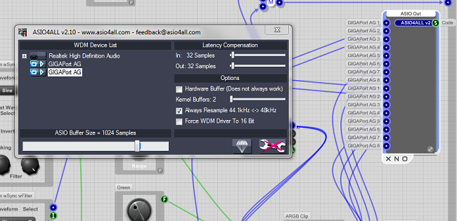

I wanted to add that ASIO4ALL shows all 16 outputs but does not work... i.e. while I can open the ASIO4ALL configuration dialog, Flowstone does not output ANY signal...?
It all seems to "work" but no output, no streaming data etc.
Not Working... but it looks like its working

Have you tried this Asio4All configuration with another software? Maybe it's not a FlowStone issue.
I guess DirectSound wouldn't work, because it only allows 1 device to be active at any time. I don't think FS could even work with multiple active audio devices, as they might have different properties (Sample rate, buffer size,sample types,...)

If it's not an obvious error, then I guess you are out of luck, because the devs would need exactly your hardware to test it. Although I don't think that's a FS problem, it just uses the same Asio implementation like every other software.
