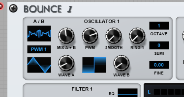

Holy Shi. Spogg i need ur help here. Its the oscilator connected to Normalize making this noise i had this trouble before with this thing. It makes this disted sound. Realy crap.
I was going inzane on this sound. And found out the problem is the normalizer.
So u need to connect something else there.
And inside this osc knobs. Its wierd to. Its 512 size there and end out in 256. Hmm i will check thoose osc knobs more to understand this. this is strange. Not uch make sense here.
It seem like ur trying to make a moprh? some how?
I have a morph in ruby working 100% + 4 diffrent pwm modes.
I did get help by nubeat for this module so i cant just give it out like this. If u ask nubeat about the morph and told him i sent you. Mybe u can have it. And do something.
But that thing works. 2 knobs for editing the waveform. And then PWM i will show u an image.
Hmm Mybe i dont need this tool
Mybe its better using that one O: This makes all u need
:D
But im not sure if nubeat wana give it out like that just.
Tlk with him mybe give him a little donation and he will give u
I also have a ruby keyboard form him u load BMP files and it works like the pro ones
hehe

Hi DJ and thanks for testing again.
I am unable to re-create any distortion in any mode of use so I don't think I can modify the schematic to improve it for you, since I can't find any problem!
What you do get is noises when you are altering levels. This is down to the green prims in use for the sliders and normalisation, but this is only while you are changing levels. The idea behind the project was to create waves for other synths, not to perform with this tool. Somehow I don't think that's your issue though.
Since you have found the normaliser is producing distortion I must ask what version of Flowstone are you using. This one is made with the latest 3.08.1 and I wonder if you are using an older version which has compatibility issues, like a dodgy normaliser for instance.
Regarding the rotary waveform knobs: Inside each one there is a basic waveform (created with another program) and saved with 512 samples. The resample prims then convert to whatever is set on the front panel as the number of samples desired.
Finally these float arrays are added together at the summing input of the Normaliser prim which then creates a table with outputs lying between -1 and +1. If you remove/bypass the Normaliser the resulting wave arrays will then vary in amplitude outside these limits which may not be an issue, if you want to adjust the output level (in the ADSR) as you mix.
if you can set the Wavemaker up so you hear distortion, save it in that state and then upload it I can test it in the exact same state and let you know what I hear. That's the only way forward I can think of at the moment...
