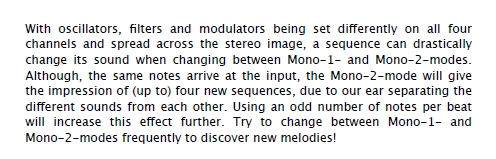

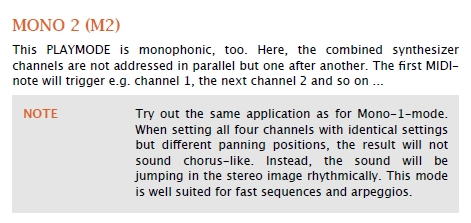

Mono 2 - (This I've no idea how to do) Each keypress sounds each synth channel in turn.
Mono 2.jpg (74.03 KiB) Viewed 16155 times
Mono 2b.jpg (62.18 KiB) Viewed 16155 times
I've read the various MIDI prim hover-over texts and - umm, I dunno :oops:

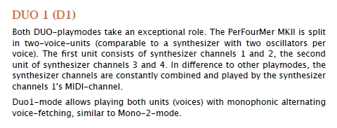

Duo 1 - Like Mono 2, but two channels heard with every other keypress.
Duo 1.jpg (67.78 KiB) Viewed 16155 times

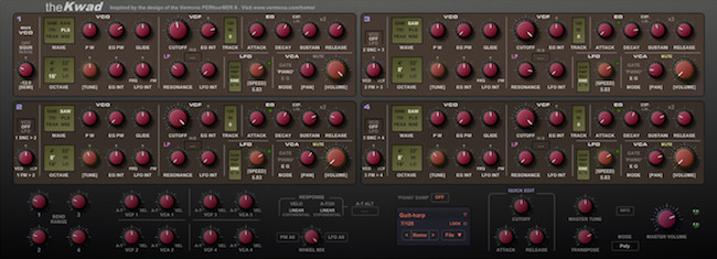

Here's what it's looking like -
theKwad copy.jpg (70.84 KiB) Viewed 16153 times
theKwad.fsm
(5.22 MiB) Downloaded 919 times
Sounding pretty great, too - still working on presets. It even does up to four-op FM with each operator having multiple waveforms, a dedicated LFO and Multimode filter.

I think that these may be way off, too; in fact, I don't think the MIDI channel has anything to do with it at all. To be fair, though, whoever wrote that synth's user guide is using "channels" to describe something more like what we'd normally call "voices"; which seems like a dumb thing to do on a synth which also has MIDI!
If I read it right, on the original synth, "Mode1" is what we'd normally call "mono unison" - all four voices/"channels" play the same single note. "Mode 2" is what we'd normally call "4-voice polyphonic" - but with the unusual quality that each voice gets to have its own settings. Each time you play a new note, it is assigned to a voice/"channel" with different settings than the other three, so each new note has its own "patch" selected from the four.

Assuming the above is correct, and the bulk of the synth is poly, then selecting the voice/"channel" would also have to be in poly, otherwise it wouldn't take place "per note". I can see two ways it might be done...
1) Have a counter which is incremented (mod 4) per note-on, then "lock" this into place using the "trigger" pulse at the start of a new note, and use it to select which path is enabled. This might sound slightly different to the original, as it would be strictly "round-robin", regardless of what note-stealing might happen when you run out of polyphony (probably not that noticeable, though). It could waste quite a lot of CPU, though, calculating the three "synth" paths that you're not actually hearing.
2) Use a custom note allocator and four fixed voices made in "blue" mono4. I have done this before to emulate something like the Oberheim SEM architecture, albeit without separate controls per voice (just a bit of randomness to emulate the inaccuracy of voice matching). This would be a very exact emulation, but you wouldn't be able to extend the polyphony, and "mode 1" would be strictly mono unison.
