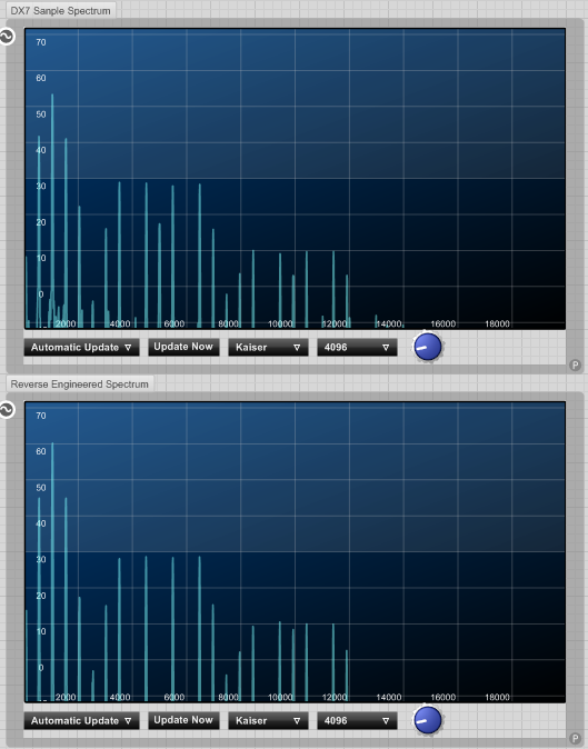

I should have written more details about my approach. Yes, my device uses FM syntesis (or more precisely phase modulation synthesis), just like the DX7. The spectrum of the original sound sample (top) is a fingerprint of the algorithm (= configuration of modulators and carriers).
DX7 Harmonica Spectra.png (139.33 KiB) Viewed 41965 times
Take for instance the symmetric pattern at the 10th harmonic, which repeats itself al tower level at the 20th harmonic. That tells you that there is a modulator at ten times the fundamental frequency, and from the repeated image you can infer the modulation index to be around 0,07. Then you can analyze more details like the dominance of the second harmonic etc. and get more hints. The synthesized spectrum (bottom) is actually quite similar to the original. That's why I said I think I got the basics right.
Of course there is more to the sound than just the spectrum, like envelopes, LFOs, keyboard tracking etc. Those are the refinements I had in mind, if somebody wants to chime in.
