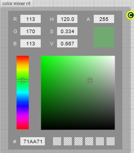

Sooner or later we all come to the point where the color prim just isn't sufficient, because it lacks an alpha channel. That's where all of us do our own solutions (mostly a module placed behind the color output, to add an alpha channel).
I think it might be better to have a generic color mixer that all of us can use - and improve. Kind of like a community project, where everyone adds whatever seems helpful and re-uploads here.

Re: Generic Color Mixer with alpha channel
PHI I'm totally sorry, I completely missed that one! So we now have two solutions.
I advice that if you prefer a green solution that is far more advanced, you should use and support PHI's color designer.
The color mixer stays Ruby-based.
New version. See first post to download.
color mixer r2 features RGB, HSV (new) and alpha. Values get immediatly updated for the other color model, so you see the changes in realtime.
Still 100% Ruby!
Usage: Click on a box and drag to change a value. Hold shift while dragging to finetune. Double click to enter a value. Use ctrl-c and ctrl-v after double click to copy/paste.

Re: (RUBY) Generic Color Mixer incl. alpha
Nice work. The layout is nice and clean.
I notice that the color goes to black when you set hue to 360. Also for the saturation and value parameters, I would personally prefer they were either formatted as percent or 0-255 (int). I think it just seems more consistent. Minor detail though.
Thank you PHI, especially for testing and, most importantly, reporting back!
The 360 issue will be corrected in the next version.
As for sat and val, I wasn't sure what to take. In fact, I already calculated them based on 0-100, but just divided the results by 100 again right before posting. That is because HSV is mathematically defined as hue in full circle degrees, sat and val as 0-1.
Photoshop, iirc, uses 0-100%, so I probably use that.
The next version will look less clean, I'm afraid, because it implements hex color and color wheel.
New version r3!
See first post for image, changelog and to download. Comments very welcome.
Post by Nubeat7 »
wow! thats amazing tulamide the colorwheel made it real mature now! thanks a lot for this, i didn't test it very deeply yet but it looks like everything is working well.. straight into my toolbox :)
Post by Nubeat7 »
just an idea to this, i see this more as a propertiestool which ( specially in vsts ) is not part of the GUI itself, to use it like this change the view to "Properties" view, add a ruby module before the output which is just a through module ("output @in" - to use ruby's persistence), and purgeable all the other modules to save filesize...
