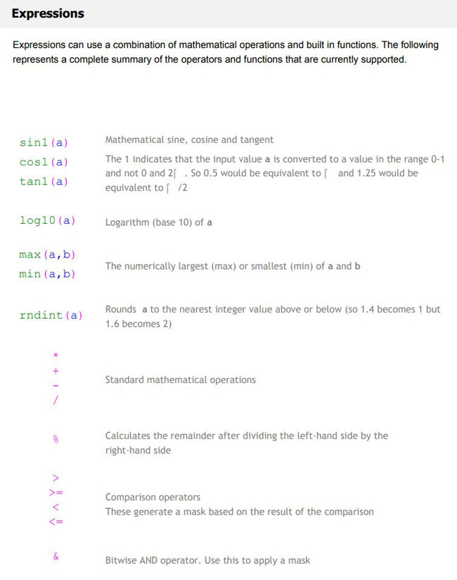

I am attaching a .fsm and a .jpg, for asking what's the specification of the sqrt(x) function that's supported by Flowstone 3.0.4. The .fsm shows that the the sqrt(x) DSP Code Component function doesn't deliver the square root of the input. Have a nice day.

Without doing anything, without sending an email, I am again allowed to attach files. The attachments are now on my post, above. The sqrt(x) doesn't deliver what one is expecting. There must me something obvious like an offset, or some rescaling. Can you please tell?
