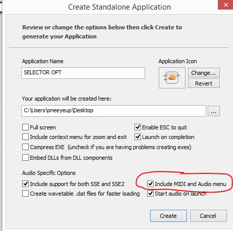

Make sure you check that when exporting exe
- Capture 2.JPG (45.91 KiB) Viewed 15548 times
Re: Microphone inputs
When you create an exe there is a dialog with a checkbox option “include audio menu” or so. Activate that option.

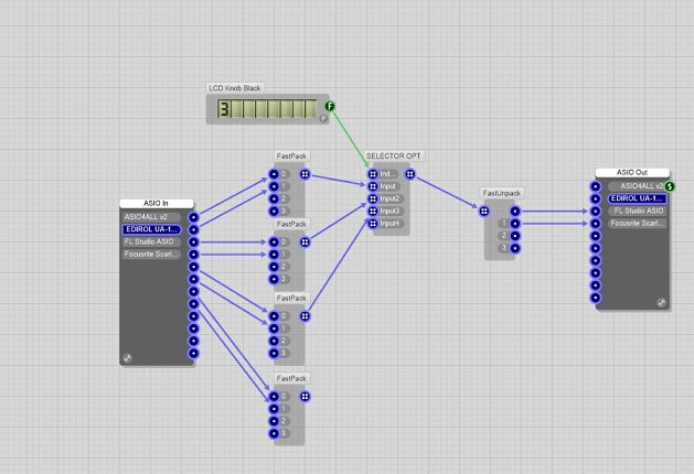

This has an audio selector menu, for internal sound driver selection- in the gui. the dial selects which STEREO PAIR of inputs get routed to the output. You could configure it to select through mono inputs as well, or any wild config for that matter.
Hope this helps, please share your results so we can all learn.
- Audio Selector.fsm
- (43.12 KiB) Downloaded 863 times

One more thing, I notice that in FL Studio's mixer, the layout for selecting the input/output for each track is similar to what I posted, BUT it has a selector list that is populated by the INPUT TITLES from the ASIO, not just their order. Much like Flowstone's Audio Selector list does with the driver selection, but FOR INPUTS. If that is what you want, I do not know what to do...
IF IT DOES NOT ALREADY EXIST, maybe someone could create a ruby or external function that pulls the input titles for whatever ASIO driver is selected into an array, and populates a drop down list for the selectors/ multiplexers.
I believe other than that, it's just a matter of your module that will be rendered to .exe, having enough audio inputs to match any asio driver selected. (mine has 10 in 10 out for example)
