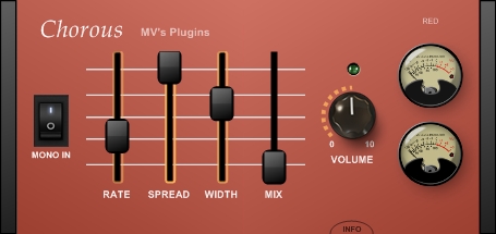

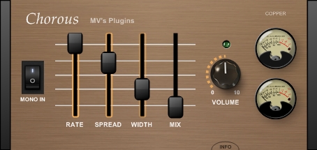

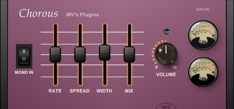

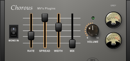

Simply marvelous! It indeed avoids the quality of choruses I've always disliked, as you describe. At some settings this almost acts as a room simulator; wearing headphones, send it a simple mono lead synth sound and as the mix is turned up, it begins to sound like an amped instrument playing in a room some distance away - standard choruses don't do this.
As to GUI, how 'bout sump'n colorful?
Clicking on the small label at the upper right corner will allow selecting a variety of colors for the BG, including brushed copper. As the sliders are turned up, the rim of their 'tracks' begin to 'light up'.
Chorous_kbGui.fsm
(3.34 MiB) Downloaded 1316 times
@Martin - I'm working on a complete re-vamp of my Yamaha CS-80-based synth; OK with you if I include this as an option to the lame SM chorus I started out with ?

I like all the colors and couldn't decide on one. The mono in switch looks quite realistic. I don't like the knob and the VU meters, they don't really fit to the rest. And maybe a better contrasting color for the volume ring and the fader outlines (dpepending on final background color of course)?
