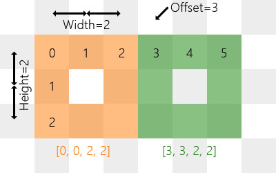

I guess you misunderstood how the pixels are selected.
Here's a drawing:
As you can see, when you say width=2, it starts in the middle of one pixel and counts to the middle of the next pixel = 1 and then to next pixel = 2, effectivly it draws 3 pixels although you just said you wanted a width of 2. The next rectangle has to start at offset 3 to not overlap, and the offset is also the midpoint of the pixel.

MyCo wrote:I guess you misunderstood how the pixels are selected.
Here's a drawing:
This wasn't the case in SynthMaker when I remember, it was changed in FlowStone, so when you use the 1/8 grid system you always draw a single pixel instead of drawing between two pixels (GDI+ allows subpixel drawing).
If what you say is really true, then (and please don't think I'd address this to you) this is the dumbiest I've ever heard of. A 3 pixel consuming area is said to have a width of 2? Really? Like, I want two apples and get one for free?
In each and every application of all times, a pixel width of 2 meant 2 pixels. I develop for almost 30 years now, in dozens of programming and script languages. Never ever had one tried to tell me that 3 pixels is really 2 pixels. Really, I can't imagine anything sillier than breaking mathematic rules.
So I have to add one to get the real result. I hope this is it. It doesn't address the overlapping issue, but let's put that aside. Need a coffee now. Two coffees. Or better three. So, in the end Big Brother was right: 2 + 2 indeed equals 5!
(Lost a week just because of ignored maths. At least there are people like you, who can point us to the issue. Thank you!)

BTW: This is how rectangle are drawn: You have a rectangle of say: 10x10 Pixel at 10x10 Pixel offset, and draw with a 1 Pixel Pen exactly on the edge of the rectangle around it. When you measure now what you've drawn you get:
Offset: 9.5 x 9.5
Size: 11 x 11
For Pens bigger than 1 Pixel, you can use Pen.setAlignment("inset") to correct for that.
